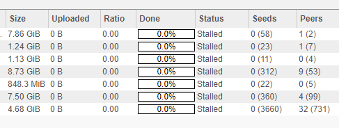

Me ha dejado de funcionar qbittorrent en Ubuntu. He probado a reinstalar, actualizar, cambiar puertos,... y nada, se carga de fuentes pero no sube ni baja nada, ni con trackers privados ni públicos.
Cualquier otra aplicación en Ubuntu, Transmission p.ej. funciona, y las mismas versiones de QB en Windows, también. Así que descarto por ese lado que sea la conexión y/o router.
También he subido Ubuntu de versión a 21.10 para descartar, pero tampoco.

@WRC Descarta eso y mira si tienes los logs en ~/.local/share/data/qBittorrent/ o en ~/.local/share/qBittorrent/

(N) 2022-01-29T17:46:22 - qBittorrent v4.3.6 started
(N) 2022-01-29T17:46:22 - Using config directory: /home/stream/.config/qBittorrent/
(N) 2022-01-29T17:47:12 - qBittorrent v4.3.6 started
(N) 2022-01-29T17:47:12 - Using config directory: /home/stream/.config/qBittorrent/
(I) 2022-01-29T17:47:12 - Trying to listen on: 0.0.0.0:54321,[::]:54321
(N) 2022-01-29T17:47:12 - Peer ID: -qB4360-
(N) 2022-01-29T17:47:12 - HTTP User-Agent is 'qBittorrent/4.3.6'
(I) 2022-01-29T17:47:12 - DHT support [OFF]
(I) 2022-01-29T17:47:12 - Local Peer Discovery support [OFF]
(I) 2022-01-29T17:47:12 - PeX support [OFF]
(I) 2022-01-29T17:47:12 - Anonymous mode [OFF]
(I) 2022-01-29T17:47:12 - Encryption support [FORCED]
(I) 2022-01-29T17:47:12 - UPnP / NAT-PMP support [ON]
(I) 2022-01-29T17:47:12 - IP geolocation database loaded. Type: DBIP-Country-Lite. Build time: sáb. ene. 1 02:11:53 2022.
(N) 2022-01-29T17:47:12 - Using built-in Web UI.
(N) 2022-01-29T17:47:12 - Web UI translation for selected locale (en) has been successfully loaded.
(N) 2022-01-29T17:47:12 - Web UI: Now listening on IP: *, port: 8008
(N) 2022-01-29T17:47:12 - Options were saved successfully.
(I) 2022-01-29T17:47:13 - Successfully listening on IP: 127.0.0.1, port: TCP/54321
(I) 2022-01-29T17:47:13 - Successfully listening on IP: 127.0.0.1, port: UDP/54321
(I) 2022-01-29T17:47:13 - Successfully listening on IP: 192.168.0.10, port: TCP/54321
(I) 2022-01-29T17:47:13 - Successfully listening on IP: 192.168.0.10, port: UDP/54321
(I) 2022-01-29T17:47:13 - Successfully listening on IP: ::1, port: TCP/54321
(I) 2022-01-29T17:47:13 - Successfully listening on IP: ::1, port: UDP/54321
(I) 2022-01-29T17:47:13 - Successfully listening on IP: XXXXXXXXXXXXXXXXXX %eno2, port: TCP/54321
(I) 2022-01-29T17:47:13 - Successfully listening on IP: XXXXXXXXXXXXXXXXXX %eno2, port: UDP/54321
(I) 2022-01-29T17:47:13 - UPnP/NAT-PMP: Port mapping successful, message: successfully mapped port using NAT-PMP. external port: TCP/54321
(I) 2022-01-29T17:47:13 - UPnP/NAT-PMP: Port mapping successful, message: successfully mapped port using NAT-PMP. external port: UDP/54321
(I) 2022-01-29T17:47:13 - UPnP/NAT-PMP: Port mapping successful, message: successfully mapped port using NAT-PMP. external port: TCP/8008
(I) 2022-01-29T17:47:13 - UPnP/NAT-PMP: Port mapping successful, message: successfully mapped port using UPnP. external port: TCP/54321
(I) 2022-01-29T17:47:13 - UPnP/NAT-PMP: Port mapping successful, message: successfully mapped port using UPnP. external port: UDP/54321
(I) 2022-01-29T17:47:13 - UPnP/NAT-PMP: Port mapping successful, message: successfully mapped port using UPnP. external port: TCP/8008
(N) 2022-01-29T17:47:13 - 'LISTA DE LOS 40 TORRENT ACTIVOS' restored.
(N) 2022-01-29T17:47:12 - Watching folder: "LISTA DE CARPETAS MONITORIZADAS"
Esto es lo que aparece en el LOG actualmente.
