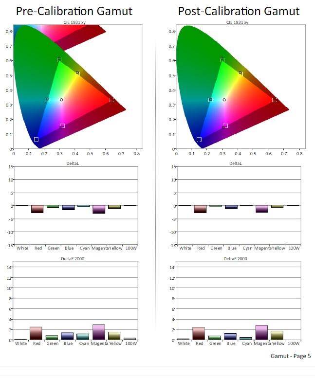

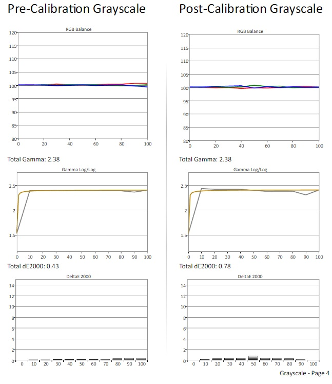

Color accuracy: Before my standard calibration, the ISF Expert and Cinema modes modes were already super accurate, among the best I've seen. As usual, OLED's superior black levels also improved the perception of color saturation compared to the LCD other displays.
