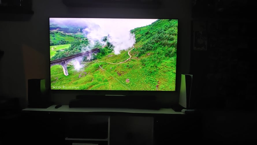

OtroSome early Impressions of the tv. QN85QN900A
Gaming : This thing is beautiful while gaming , color really pop out in HDR mode , and black look really inky the game bar is a great addition to the tv. Yesterday i did notice some uniformity issues where i could see white cloud when the game was in a black loading screen mostly transition to one level , example COD when you are entering a loading screen. But today that didn't happen it might be because of the update i got for my tv and the local dimming is kicking in faster.
Blooming: Well , i don't know how i feel about this one yet. In some scene there is a lot of bloom in movie mode with local dimming set to Standard. On the other hand in other scene is perfect. Normal black bars look inky black in some scene the tv disappeared from the wall in a pitch dark room this might be because of the infinity design ( for me this give the tv a very premium look). So i guess with some updates this should be fixed.
Brightness and Contrast : Well I'm no rtings , My model is the 85 inch QN900A and i have an 77 inch oled cx in my bedroom which im using as a comparison , and i can say this tv contrast feel mile ahead of the Q90R and the Q9FN there's this pop in some scene that really makes me question the rtings review when it comes to contrast and brightness. In some scene you feel that scene want's to jump out of the screen that I don't feel with the cx. Brightness is something else in this tv , I don't have any measurements tools but I can say full heartedly that this tv gets brighter than the numbers rtings are getting.
Sound Earc. @Nillaz pointed out that when is connect to the xbox series x using Dolby Atmos in some instances you loose sound , I experience the same bug and changed to uncompressed 7.1 to fix this issue. Guess it's a bug and will be fixed. Earc device is a Marantz SR6014.
DSE : No dse so far screen is clean
Early impressions, one sentence.
Holy Ch1t is this thing bright.
This is coming from a Q90r in terms of pop and brightness there is no comparison the QN900A is a generation apart.

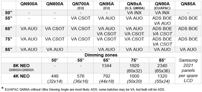

Review miniLED 65QN95A (para America QN90A) también con la lotería del panel que te pueda tocar una VA AOU ó peor una VA SCoT, pues lo dicho persiste el blooming, no han desaparecido.

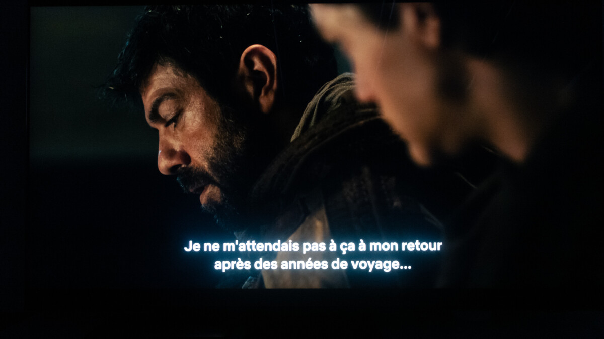

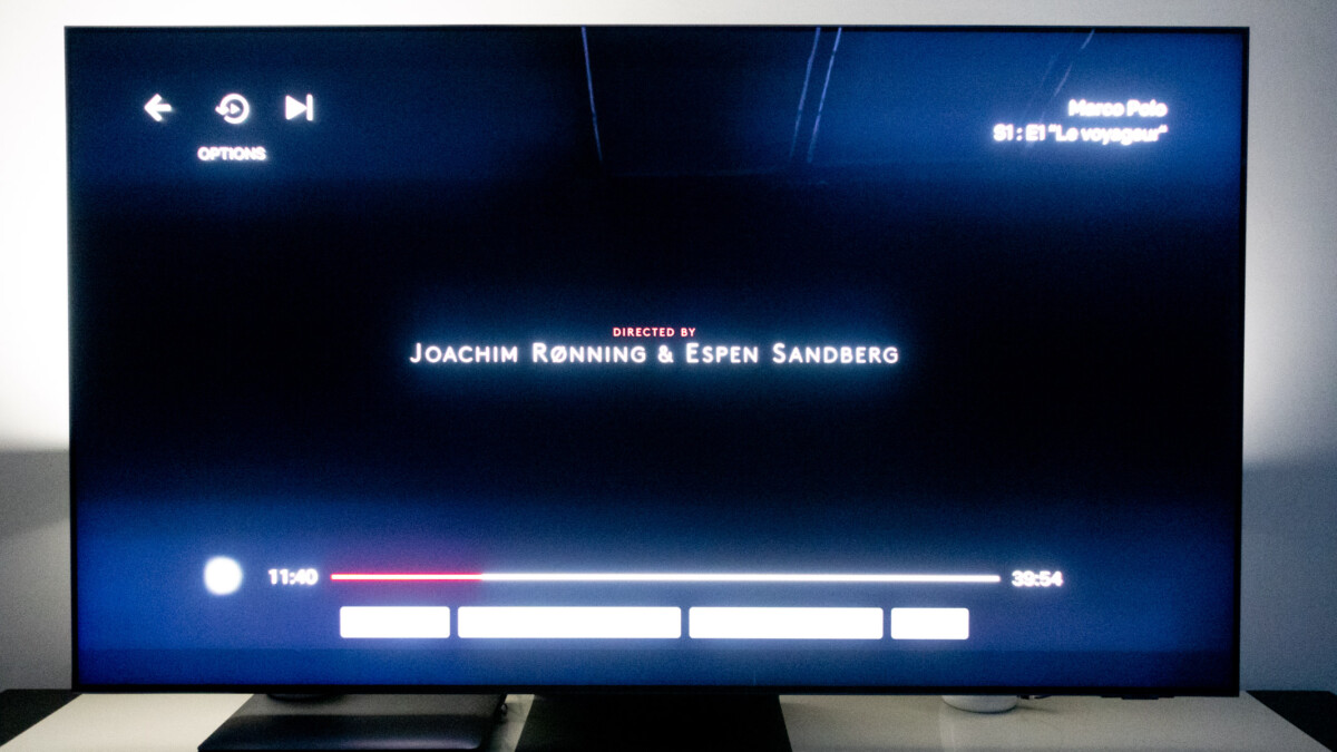

Blooming.
Holas, pero esto es el colmo de la tergiversación o estoy equivocado:Lo de abajo no es blooming como tal, es solo al sacar los menús, es absurdo en la q90r lo hacía lo quitaron y luego pusieron, y luego rebajaron hasta casi eliminarlo, pero es eso, al sacar menús, no en el contenido real.
La segunda foto está sobre expuesto las letras, pero es que lis subtitulos basta con configurarlos y se ven perfectos, y has de hacerlo además o te dejan ciego
