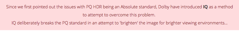

Dicho por Steve Shaw de su puño y letra:
think it needs to be pointed out that 'calibration' to a given standard is defined based on the viewing environment, as per the info I linked to previously.
If you have a non-grading environment then the calibration target changes, again as per the info I linked to.
For SDR, 200+ nits, and a gamma 2.2 is entirely desirable if the viewing environment is light contaminated.
Unfortunately PQ based HDR never took that into account, and was only valid for a 'grading' environment.
Something we pointed out to Dolby when the first iteration of PQ was defined.
And that is why IQ now exists - to break the PQ standard for non-critical viewing environments.
But, basing it on a non-calibrated light sensor, and dynamically changing the image based on the sensor is, well, just bollox.
