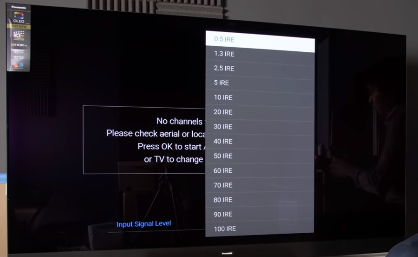

Hola cómo estáis, creo que esta afirmación es inexacta.
Tal vez la luz de sesgo os hizo una mala jugada, pero en el otro extremo del HDR ocurre en algunas TVs lo que se denomina BLACK CLIPPING. El siguiente comentario habla de ello.
The minimum level (the black level) is usually just the minimum the display can attain, and can range from very dark (0.0001 nits for example) on OLED displays to higher levels (around 0.03 nits or even higher) on cheaper LCD displays. The maximum brightness is often set far higher on home TVs to overcome surrounding room light levels, with many home TVs set to 300 nits, or more.
Note: The statement that 'The minimum level (the black level) is usually just the minimum the display can attain' refers to the fact that often OLED black can be too low, and users often chose to lift it to prevent shadow detail clipping/crushing, and that becomes even more apparent with home HDR OLEDs. (en LCD existe limitación tecnológica para black level)
Different viewing environments really need different display gamma, which the 'Absolute' PQ based HDR standard cannot address.

Hola estamos 2020, el hablar de chrominance overshoot NO sólo es de C8/E9, AF8/AF9 ó Panasonic FZ800/1000 también, porque macroblocking se ha identificado en todas ellas, cada empresa ha empleado el algoritmo más conveniente para mitigarlo.
Os coloco valor asignado en nits siguiendo la curva HDR ABSOLUTA hasta 1000 nits publicado por el gran Ted.
For the complete 21-Point Grayscale target Luminance SMTPE ST 2084 curve, look below:
1.000 cd/m2 for 100% Grayscale
621,5 cd/m2 for 95% Grayscale
388,8 cd/m2 for 90% Grayscale
244,4 cd/m2 for 85% Grayscale
154,2 cd/m2 for 80% Grayscale
97,3 cd/m2 for 75% Grayscale
61,3 cd/m2 for 70% Grayscale
38,4 cd/m2 for 65% Grayscale
23,9 cd/m2 for 60% Grayscale
14,8 cd/m2 for 55% Grayscale
9,4 cd/m2 for 50% Grayscale
5,6 cd/m2 for 45% Grayscale
3,3 cd/m2 for 40% Grayscale
1,8 cd/m2 for 35% Grayscale
1 cd/m2 for 30% Grayscale
0,5 cd/m2 for 25% Grayscale
0,2 cd/m2 for 20% Grayscale
0.1 cd/m2 for 15% Grayscale
0.03 cd/m2 for 10% Grayscale
0.006 cd/m2 for 5% Grayscale :yes
El valor para 10% grayscale mínimo lo obtienes en el mejor LCD para SDR, ya que en HDR este valor mínimo por ejemplo para Q90R según flatpanelshd alcanza la cifra nada despreciable de 0.1 cd/m2, en Z9F hasta 0.2 cd/m2 que correspondería al 20% grayscale, por lo que todo valor por debajo de estas cifras técnicamente es recortado de un plumazo.
No niego que estáis convencido de apreciar en la Q90R "mayor" detalle en sombra que OLED, pero la realidad es otra. Ello está fuertemente supedidato a viewing enviroment, así como lo comentado tiempo atrás:
Sobre "sacar" más detalle en sombra en LCD como que no es tán correcto, esto sucede porque es un display retroiluminado. Si me dejo entender, un detalle en sombra de un video SDR /HDR que debe verse por ejemplo a 0.005 nits pues lo observas a 0.05 nits en LCD, de igual manera un detalle en sombra de 0.01 nit pues lo ves por ejemplo a 0.1 nits. Es muy muy importante visualizar un TV en un ambiente adecuado, más si es UHD HDR.
+14/5 HDR tiene una curva de gamma absoluta, pero los TVs de hoy en día pues la rompen. HDR no se ve oscura o quema detalles, muestra la imágen con su luminancia correspondiente. Todo es cuestión de educar nuestros ojos, entender que hemos maleducado la vista por mucho tiempo.
Un saludo.

Si fuere el caso que dices, en el estudio de comportamiento visual humano que hizo Dolby para lanzar el HDR, hubiere considerado el nivel de luminancia asignado de 0.5 nits a 10 000 nits pero NO es CERO, porque debajo de 0.5 SI que existe detalle en sombra. La magia del PQ EOTF es que con el rango dinámico estático que es 10000:1 del ojo humano podáis disfrutar del estandar HDR.
Panasonic que se esmera en perfeccionar su OLED TV para HDR, no sólo se fija en highlights muy por el contrario near black.
Nota: IRE 5 SDR = 0.005 cd/m2 (nits) para gamma 2.2
Disculpen el offtopic
La escala la considera desde 0 porque es el negro, si no, no contemplaría el negro y empezaría desde el gris, nunca veríamos nada negro.
Saludos.
